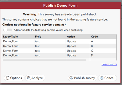

I added a file question to my test form and got this:
To resolve this, I...

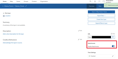

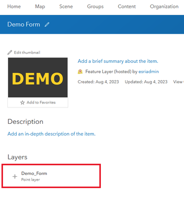

1. I went to the Feature Layer in Portal, then the Layer:
2. I clicked "Enable Attachments"
3. Then I went back to Connect and was able to publish (Ignore the random additions. The point is the database won't be wiped out):

Generally it will only prompt to overwrite when a field is incompatible (i.e. string vs integer), or you're adding/updating a repeat (table). Much better than the pre 2.5 days where it always overwrote...
