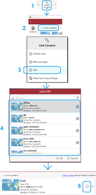

My apologies. I'm not sure I understand. See below for clarification. I believe you are wanting Option #1?
Option #1: A select_one or select_multiple set up as an External Select (e.g., select_one_from_file my_file.csv) should not need any interaction from Connect if set up properly.
Once you publish the form for the first time you can:
  1. Go to "Linked Content"
  2. Click on "+ Link content"
  3. Choose "CSV"
  4. Select your hosted CSV from the list
  5. You will see a download icon next to your CSV. This is both optional and annoying (see Notes at the end). To keep it simple, I would recommend clicking this button the first time you link to the CSV... and any time you republish the form in the future if the CSV has been updated.
Now, when someone visits the webform, they will get the CSV. Subsequently, if you update the CSV on your portal, they will automatically get that new CSV's content when they reload the survey/page. Again, you do not need to use Connect at all.
  3. Choose "CSV"
