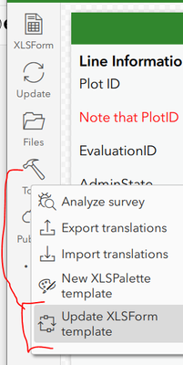

If your form is old then you can type it in.
There is also a a new tool to update the form then you should get it.  First upgrade Connect.  Note numbers only shows up for integer and decimal.
If that fails then your form is really old and I can walk you through how to do it.  I got a post somewhere.

Ok updated to 3.19.104. And tried the 'Update XLSForm' and got this

I'd close the XLSX before converting.
For very old XLSX forms that don’t want to auto update:
  • Compare the columns in the old XLSX to a brand new XLSX (just create a new blank form).
  • When you notice a discrepancy (aka, missing column in the old XLSX), manually add a new column to the old XLSX so the columns match the new one.
  • After that, copy everything in the old XLSX (i.e., rows 2 to x - where x is the last row in your XLSX) into the new blank XLSX. Be sure to paste as text only.
  • Copy over the choices tab and settings tab as needed.
  • Done. Now, just replace the old XLSX with the new one.
