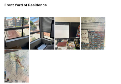

I have a survey with multiple photos possible.
In my word docx template I have the following which will include all photos taken.
 ${#picture_of_front_yard}${$file | size:150:0}${/}
I'd like to do two things.
  • If no pictures, hide this from the taking up space in the report
  • Add a border around each photo
    • Right now they look like this and I would like a little separation if possible.
Thank you,
Mele

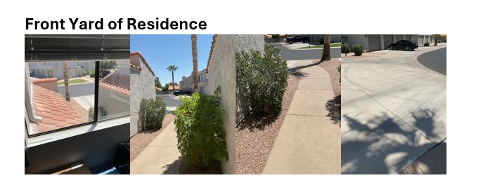

I don't use Survey123 for reporting anymore, but I reckon you could get creative with concatenating the image with a string to achieve the kind of border I think you are describing. Totally untried guess here, but something like
${if picture_of_front_yard}${#picture_of_front_yard}${$file | size:150:0}+ ${/}${/}
You may have to jigger the location of the + and the empty space following it, I'm not sure if the classic empty string ( '' or "" ) would work here.

This worked for hiding the image section if no images exist.    Just need the border if anyone has suggestions
${if picture_of_front_yard}${#picture_of_front_yard}${$file | size:150:0}${/}${/}
Also, just a friendly suggestion, when I was working in Survey123 reports I found it insanely useful to color-code my content-control logic (like the blue text above) so that maintaining templates and changing them over time was less of a lift in the long run.

Thank you @MattEdrich I am still playing around but your idea makes space as I wanted.   One thing I did was make the font 'white' and it looks good.     Thank you for the suggestion.
