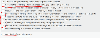

Glad that is working, just a heads up, you have some of your relevant calcs that don't provide a user type or meet the requirements for a more advance license but give a lesser license, for example  You may want to get rid of the count-selected here:
You already are require 5 specific answers, but if you answer those 5 and plus another one, you get either nothing or just "Professional".  If those 5 are checked no matter what you should get "Plus".
Also something is overriding the "Plus" with the first answer.
I guess just make sure you relevant calcs give you what you are expecting.
