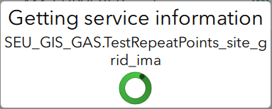

I'm testing nested repeat using feature service I created in a geodatabase. I made three layers of repeat, and the last repeat will upload images with some notes. It's Survey-Site-Grid-Image structure. I created three related tables (site, grid and image tables) and I enable attachment to only the image table. The "Enable Attachment" created one more table and relationship class. I also created the relationship class for each table (except the last attachment table because the relationship was already created.) When I published the dataset, I added the feature layer, site table, grid table, image table, and the attachment table into the map, then published them.
I created a form from the dataset using Survey123 connect, and edit the XLS. I tried not to touch too much, so I edited only the labels and added "query=1=1 allowUpdates=True" to the bind::saveincomplete field for the begin repeat rows. Then published the form. It published successfully.
I downloaded the form into my field app (Windows version installed into my PC), and filled the survey, then submit. The problem is the submit never complete. The submission got stack with this message below. The table name is the image table in the dataset. I had no problem publishing the form, so I'm guessing I made a mistake during setting up the related tables especially for the image table. Or I shouldn't include the attachment table to the dataset?

I removed the table from the map and re-published it. Re-created the form and published. Now it stacks here...
It looks better than before (it's sending data) but it's been 30 min, and still not completed. I attached 5 or 6 photos but they are all 10 to 30 KB, I think the total would be less than 100 KB (not MB!). I can't tell if I should wait for more...
YukoYokozawa
Okay, I checked all the features in the geodatabase and found the data I sent. I actually used the iOS field app to try again, and it stacked at the same message. Both data from Windows and iOS apps are in the feature layer and tables. I'm happy the data showed up in the tables, but I don't know what to do with this not stopping message. In the iOS app, I forced to close the app and re-open it, then I found the survey is in the outbox. So I tried to send it again, and the same thing happened, and there are the second set of the data in the geodatabase. This is not good...
