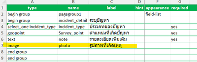

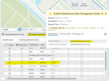

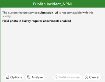

I have created a survey123 from existing feature. i also enabled attachment the feature as below picture but the survey123 connect did not allow me to public the survey and require to enable attachments.
How can i public the survey form?

When an attachment is activated in a layer in the database, a field as picture should not be created; instead, there should be an attachment table. When existing runs in survey123, the attachment table is among the begin repeat and end repeat options.
First, can you correctly create attachments in the database? Then can you try creating survey123 using the layer you published?

thank you so much! Already published as the way you told me.
