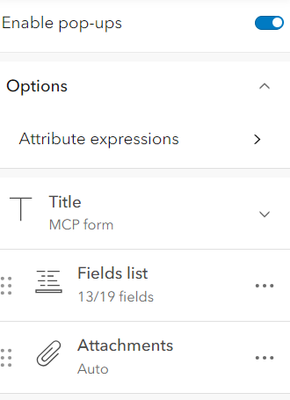

Are pop-ups enabled for this specific layer? It is a setting in the web map.
Configure pop-ups (Map Viewer)—ArcGIS Online Help | Documentation
EdHixson
Hi there Andreas
Yes I believe I have that enabled correct, let me know
ATB
-Ed
