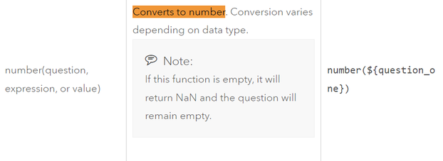

well, if you're trying to add numbers together, they would all have to be number types.
i.e. if you want 1 + 1 = 2, those are number types. If 1 + 1 = 11, that's text.
Here's a screenshot from the Survey123 documentation showing the syntax to use in your calculation to make sure they are all number types.

LynneWarwick
Thank you! the cell where the calculation is, needed to be set (formatted) as a number.
