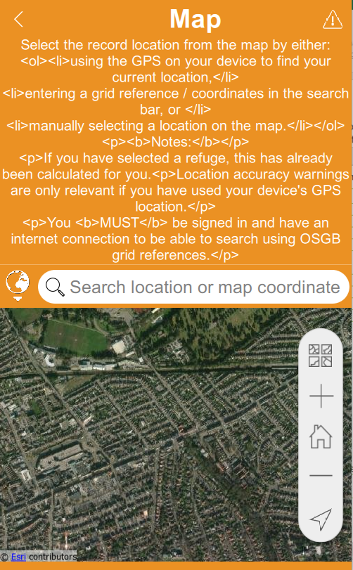

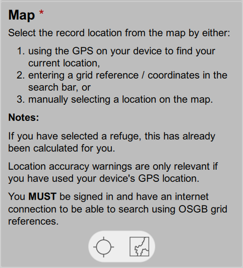

On a Survey123 form (developed in Connect, to be used in the field app) we have html formatting for several labels and hints (e.g. bold text). In a geopoint question, we have html formatting for the hint. This displays correctly in the form (tested in the field app) but the same hint is shown in the map view with the html codes but without the actual html formatting. Is there any way around this?
Hint html below, along with screenshots of the form and the map view affected.

Hi Rob,
This issue here is that your first line ("Select the record location from the map by either:") is unformatted from a HTML perspective. If you add tags to this line (eg <p> tags), the HTML formatting for the rest of the hint will be honored in the form and in the Map widget. Note that the hint text in the Map widget is center justified
<p>Select the record location from the map by either:</p>
