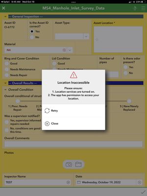

Hi @ahargreaves_FW ,
If the user has not clicked the locate button (below the home icon) manually, the warning message in your screenshot shows up because the geopoint question is designed to get the device location on loading the survey and it failed to get the device location (can be caused by various reasons).
You can disable this behavior by setting the default value of the geopoint question to null, just like the screenshot in Ismael's reply and still use the "&center=<lat>,<long>" to set the location dynamically. Please find more information in this document https://doc.arcgis.com/en/survey123/desktop/create-surveys/geopoints.htm#ESRI_SECTION1_6B32C981BC5E4... .

Hello All,
I have been troubleshooting for a few days why a custom URL that works perfectly with surveys created in August with the Geopoint question using &center={POINT_Y},{POINT_X} is currently not working on a new survey (Created in Survey123 Connect 3.14.274). Same &center={POINT_Y},{POINT_X} is still working in the other surveys. Will the functionality stop if an edit is made to these surveys and I have to republish in this new version of connect? Note, the other fields specified in the same URL are being brought into the survey successfully.
I worked with an ESRI technician not more than a few months ago to ensure my URLs would work across all of the types of devices people have. This is the 5th time I have had to rework URLs (Currently managing  25+ surveys and web apps).
I am also getting the Location Inaccessible notification. This never came up previously. Previous surveys do not have a default value at null. I now have set the default to null as explained above. I am still getting the notification. They are also set to required and read only as specified in documentation. And on top of the notification, I am still not having the geopoint question work.
Help solving this will make my week so much better!
