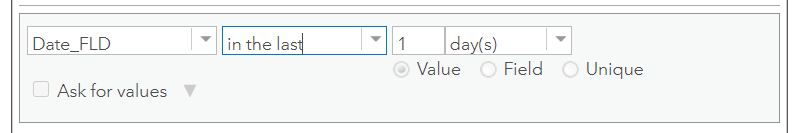

Thanks Zach, reading through the thread it looks like a relative date filter will provide what is needed here. You cannot set a dynamic filter with an Arcade expression per se, but filters are automatically applied to any new features in the layer.
In my example below, if this relative date filter is set in the web map or visualization tab, it will immediately show any new features that are added and will not show features older than a day.
Hope this helps,
-Peter

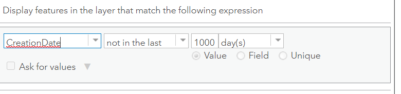

Hi Wing Cheung‌ this is not currently possible but is under consideration per this idea: In AGOL allow queries/filters by current date. It would be worthwhile to upvote the idea and post your use case.
As a workaround, you may be able to use something like:
Hope this helps,
-Peter
