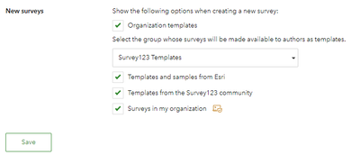

You could also set up a group in AGOL to use as a survey template group and share the surveys you need to that group, then go from the Templates category under Organization when creating a new survey. Understanding Survey123 organization templates - Esri Community
ACTUALLY as I'm typing this I discovered in the Settings under Organization on the Survey123 website there seems like there is a checkbox for Surveys in my organization that will then show them in Survey123 Connect. It should be the default I think, and it shows more than just the survey forms but this still shows them!
