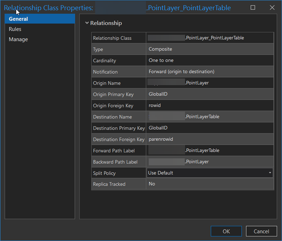

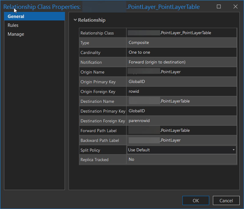

I have created a feature class with Global IDs and enabled attachments. I have also created a table that would capture additional details and set a relationship.
I published this in our portal and at the time of creating a survey from this feature service it does not pull the related table to enable the repeat on.

Did you publish the layer as a Hosted Feature Layer or a referenced non-hosted Feature Service? If the latter, is it in an enterprise geodatabase?
There are several additional requirements when creating the service yourself (i.e. not using Survey123 Connect and Hosted Feature Layers).
It's very likely the situation you are encountering is to enable 'supportsApplyEditsWithGlobalID' property. You also need to ensure that all layers, including the parent layer and related tables, have globalid fields. I can see you have the relationship key 'parenrowid'. Personally I'd just follow the default Esri one and have 'globalid' and 'parentglobalid' as guid fields across all tables and use these for the relationships.
