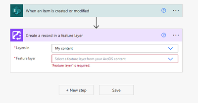

I want to utilize the Sharepoint and Survey123 connector in Microsoft Power Automate to automatically submit a survey if an item is added to a Sharepoint list.
Why can I not submit a survey using power automate but I can trigger flows based on survey responses? The only options for Survey123 actions are to create a report or get survey responses.
abureaux
MVP Frequent Contributor
"Submit a survey" is a human thing. I think what you are looking for is "Create a record in a feature layer". That will do what you are looking for most likely. E.g.,
Not something I have tried in this context, but you should be able to link up the "Create report" function with this to generate a feature report.
