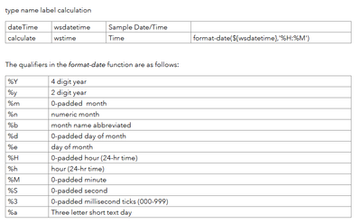

maybe the following might help
How to pull the year from the Date type?

Everything you need to know on date/time in S123: Dates and Time in Survey123
