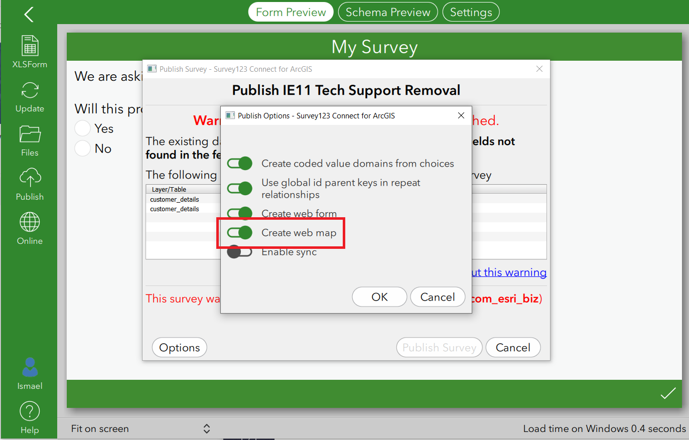

With the new versions Connect keeps making web maps on every new form publish.  I do not want any maps made.  I cannot seem to find anywhere to turn this off.
How can I get it to stop this?

In Connect, click on Publish, then open the Options dialog. See below for details.

I think I found my issue.  You must reset the settings every single time you publish.  It does not seem to remember my choices at all.  Would be nice for it to.
