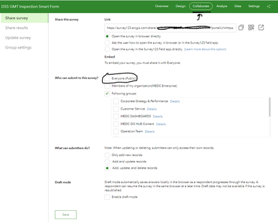

Yes, after publishing the survey you can manage the collaboration and share the survey to {Everyone (public)} as you can see in the below snapshot:

FYI Hussam, just wanted to follow up on this response. While what you suggested is true and appreciated, apparently Javascript isn't supported when the form is made Public:
https://doc.arcgis.com/en/survey123/desktop/create-surveys/pulldatajavascript.htm
Not quite sure why but there you go, a heads up. Thanks again for your quick response, Hussam!
