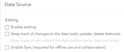

Survey123 website seem to have settings for the view only. It seems to be the case when a survey is published the view is defaulted to only allow users to submit and the hosted feature layer has full editing but is not shared.
I've tested it this morning and sharing the HFL to a group gives them full editing, even though when I go to the settings of the layer it looks like below. The settings below seem to be superseded by settings applied when it's published.
I find it strange as I've always managed the permissions for editing in the settings of the layer in Portal but seems I don't need to now.
