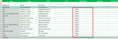

chiragtiwari
Dear Philip,
Here is the section of the survey in question.

Like @Anonymous User anticipated, using the hidden appearance looks like the best choice here. If you also apply a relevant statement, the question values will be set to null if the relevant expression evaluates to false.

I selected hidden in the appearance field but it doesn't do anything.  Can you please advise.

Hi @chiragtiwari ,
What version of Survey123 Connect and the field app are you using? You need to be using the latest 3.11 release of both applications for hidden appearance to work.
