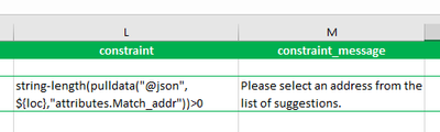

Creating a view of the ArcGIS World Geocoding service and customizing the types of locations you want the service to return would probably be the best way to go. This way the suggestions list would only include the types of locations you want. You would then set your geocode question to that custom locator in the XLSForm.
You may also want to set a constraint on the geocode question to make sure only responses from the geocode service are allowed to be submitted. Without a constraint it is possible to submit the raw search text if the user doesn't get any suggestions and then hits enter. One approach to the constraint expression would be to test that the address returned from the geocode service is not null (see example).
