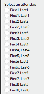

In theory, this should work however it returns a list of all records from the attendance field instead of just the ones that match the parentglobalid:
