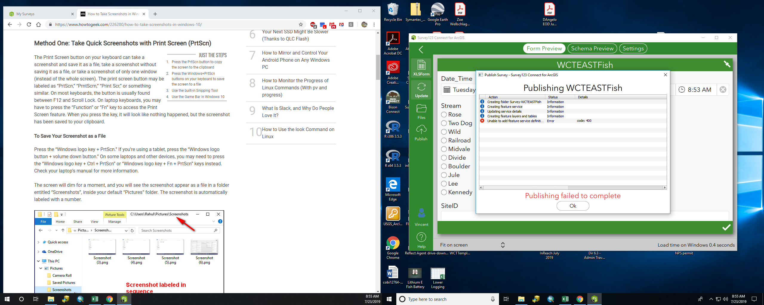

Hi Rachel,
Thanks for the reply. In response to the first question, yes, I had gone through the Content folder and deleted surveys with same name that were there due to previous publishing attempts and I was still getting the error. Today, though, I didn't get any errors. Both surveys that I was previously working on published just fine. I can't prove this but it could have been connectivity related, I work for a fed agency and our network seemed slow last week and is functioning much quicker today. If it happens again I'll try Fiddler and include those files. Thanks again
Vin
Hello Vin,
Glad to hear that things are working! Network connectivity could certainly be a cause of this one!
Let us know if it comes up again!
