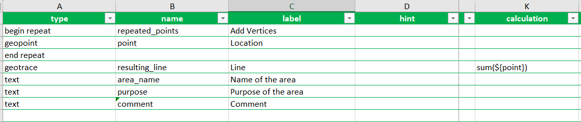

I use the expression "sum(${point})" in the calculation column to generate the line :

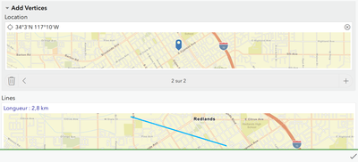

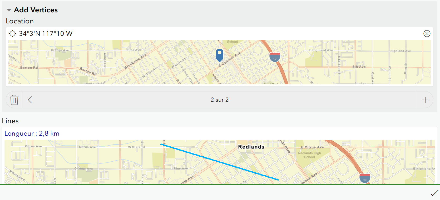

When setting up the form in Survey Connect, the preview works well, the line is generated properly :

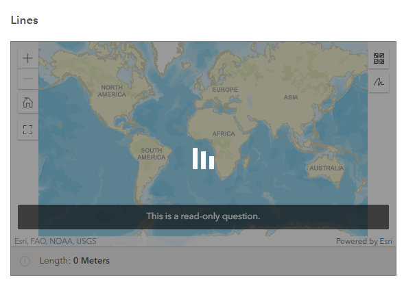

However once the form is published and used online, the calculation for the line runs indefinitely (even when changing the points in the repeat).
When the form is submitted, the results do appear in the Feature service (the points are present in the point layer as well), however the line geometry associated with the record is empty, but the other attributes are populated.
