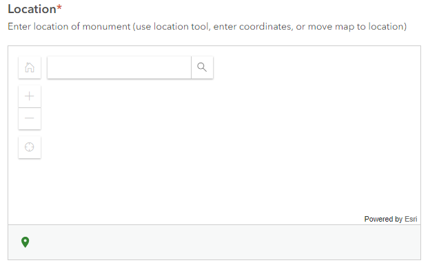

I'm new to Survey123 and just published my first survey to test it out.  However, the GeoPoint feature to gather location info isn't working.  It just shows a blank map that doesn't load (see image below).  Also, it appears that the only default basemaps to choose from are those created by my organization.  Is that how it should be?  Is there another reason the GeoPoint isn't working?

It looks like the basemap you are using (Utah Topographic Base map (WMTS)) has a WMTS layer; this causing the map loading to fail.  Researching it, it appears the web form is lacking a setting to properly make the initial GetCapabilities request to connect to the service; I'll file an issue to get that addressed.
In the interim, can another web map be used for the survey?  This may not be feasible as it would require a new basemap be added to your organization's basemap gallery.

Thanks for the response and identifying the issue.  I did find that one of our basemaps works in the survey, so I can use that for now.  Is there any estimate on when the web form GetCapabilities request issue will be resolved?  Thank you,

It appears that some of the base maps that weren't working in the GeoPoint a couple weeks ago are working now.  However, I've been playing around with the search bar in the GeoPoint question and it doesn't seem to work at all.  I've tried using a city/state/zip, a well-known place name, and lat/lon and it always returns no results.  Is this a systemic issue or is it related to a base map/my survey only?  An example picture is below:

Yes, the basemap change was minor enough we were able to incorporate it in a set of last-minute fixes before the release.  On the address, it is working correctly for me with just the zip code or with 'City, State ZIP' (note the lack of a comma after state).
ErikNeemann
Hmmm...It still doesn't work when I try either of those combinations.  It thinks for a while and then gives "no results."  I'm not sure what to do from here.
