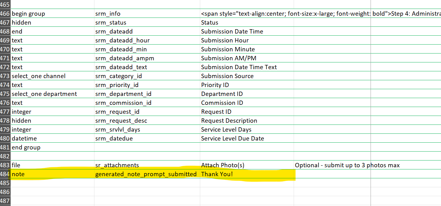

Hi Everyone,
I'm using Survey123 Connect v3.22.49 to publish a lengthy form XLSForm to ArcGIS Online.
My XLSForm, although long, is quite simple, it contains a series of groups (collapsible sections) and no repeats. I've published the form successfully and all appears to be working and I'm able to view, use, and submit on the web version.
However, I further wanted to customize the form by leveraging 'generated_notes_prompt_submitted' in my XLSForm and thats when problems arose. I'd like to customize the post submission screen however when I add the generated note to do this it "breaks my form" in survey123 connect (preceding questions not behaving correctly) and when I try to publish it gets stuck on 'Checking Feature Service' and just hangs to the point that I have to close Survey123 connect and re-launch.
It's strange because I have another form where I have this working with no issue at all.
Anyone run into this issue? Or found a workaround/solution?
Thanks,
Paul

Just wanted to flag an additional detail here that is odd:
When I add the note - 'generated_note_prompt_submitted' at the end of my XLSForm and save it, for some reason in Survey123 connect the Schema tab section becomes empty as if Survey123 connect can no longer read the XLS file and its question fields.
Not sure if this behavior offers any clues as to what could be happening.

@DougBrowning I just did a re-install of Survey123 Connect and created a new form from scratch and added a handful of form questions including a 'generated_note_prompt_submitted' at the very end and still experiencing the issue. Given this I submitted an Esri support case so they can take a look. Will post the solution if one is found working with Esri support.
PaulLefaive2
Just an update on what appears to be causing the issue:
A 'generated_note_prompt_submitted' note in Survey123 Connect which is used to customize the "Thank You" page following submission doesn't appear to work with XLForm styles outside of the default style (left blank) or the Pages Style. It doesn't appear to work with Fixed and Dynamic Grid styles unfortunately.
Web Designer does allow for modifying the Thank You page however I'd like to display calculated values from the form and present them to the user upon submission (ex. case id number).
I haven't found a solution or workaround yet but thought I'd post the cause of the issue.
