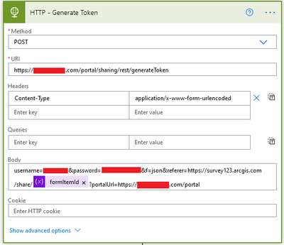

  5. Add an HTTP and configure as per below. username and password are plain text and should be your Creator level account that will be hosting this survey. Personally, I only allow a single account to publish our live surveys to simplify the automation process (this also helps in other areas, such as general content control). TIP: Name your Steps. Below, I named mine HTTP - Generate Token

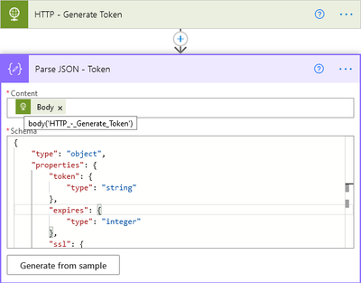

  6. Add a Parse JSON
    1. Content is the Body of your HTTP above.
    2. The Schema? Just copy-paste:
          "type""object",
          "properties": {
              "token": {
                  "type""string"
              "expires": {
                  "type""integer"
              "ssl": {
                  "type""boolean"

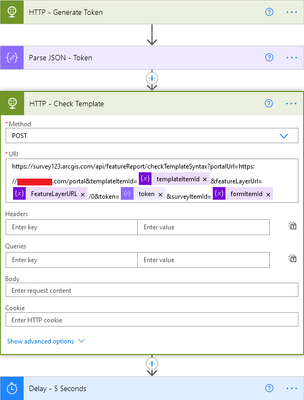

  7. Add another HTTP and format as per below:
  8. As per the above image, I added a 5 second delay. It seems to help, but maybe I am just imagining it.

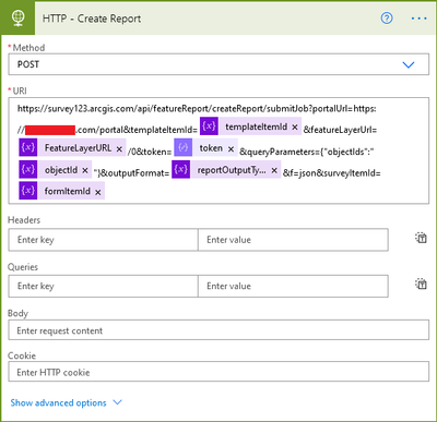

  9. Add an HTTP and format as per below

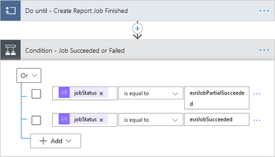

  12. Add a Do until
    1. Click "Edit in advanced mode" and add this:
      @or(equals(variables('jobStatus'), 'esriJobSucceeded'), equals(variables('jobStatus'), 'esriJobPartialSucceeded'), equals(variables('jobStatus'), 'esriJobFailed'))

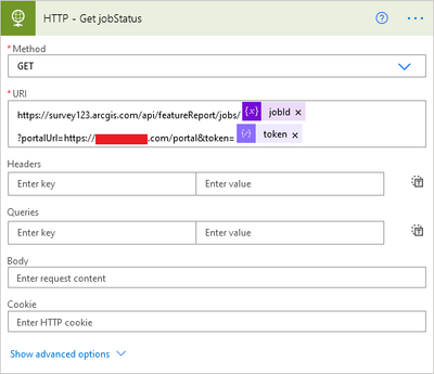

    2. Within the Do Until, add these steps:
      1. Delay - 5 seconds
      2. HTTP

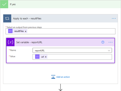

  13. Following the Do Until, add a Condition and set it to Or
  14. On the "Yes" side:
    1. Add an Apply to each
      Output from previous step: resultFiles (From the Parse JSON in my step #12 above)
    2. Within the Apply to each, add Set Variable
      Name = reportUrl
      Value = url (From the Apply to each you are currently in)
    3. Below the Apply to Each, add HTTP
    4. DONE! If you want to send your pdf/docx somewhere (e.g., in an email), attach the body of the above HTTP. When you specify the file name, dont forget to add the extension. Example:

RyanB1
Hi Abureaux
Looking at step 12 part 3. At the moment its coming up with the below. Is this correct? or is a txt file i cant get access to?
  1. Parse JSON
    1. Body is from the HTTP directly above
    2. Scheme, copy-paste:
      2.txt
