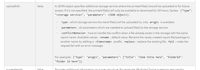

I'm getting a window showing the Survey123 generation options. But I cannot choose the option to not save the report in my ArcGIS account.
Is it possible to specify where the generated report will be saved ?

It appears, reports can only be saved via API to a folder in your account.  Have you looked into to using Power Automate (or other webhook service) to process the file once generated?  Or possibly python to download the reports from the specified folder to your repository?
