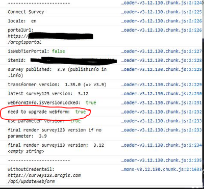

I came across this issue today for a survey embedded as a web form within a VUE js app:
"The webform needs to be upgraded, but an error occurred while upgrading." HTTP 504 Gateway timeout
The survey was published with Survery123Connect v. 3.9.120 to an ArcGIS Enterprise Portal and it appears that the survey123.arcgis.com api is "forcing" it to be upgraded to 3.12 and it is possible that the process timed out because of network speed.
The setting within the survey for forcing an update is turned off.
The only way to resolve the issue was to install S123Connect 3.12 and to republish the survey.
Is this a new "feature" of Survey123?
Is there anyway to stop survey123.arcgis.com from trying to force an upgrade while the user is trying to access the form? Is there another setting that can be modified?

You mentioned that the form is embedded in another application.  What is the embedding mechanism?  Are using the version=latest URL parameter to require the upgrade (it appears so based on the console log you provided)?
The easiest way to resolve this would be to republish with the current version of Survey123 Connect.  With regard to the 504 error, it would be useful to open an Esri Support ticket to try to diagnose what is occurring.

It does not explicitly include the parameter version=latest, so I suspect that
https://survey123.arcgis.com/api/jsapi is appending that when he web form is called?
Is there any known incompatibility between the latest Survey123WebForm and S123 v 3.9 published forms?
As stated in the post, I have already resolved the issue by republishing with the latest version of S123Connect, but am interested to find out the underlying issue so that we can prevent it from happening with other surveys at other clients where they are using surveys published with an older version of S123Connect.
