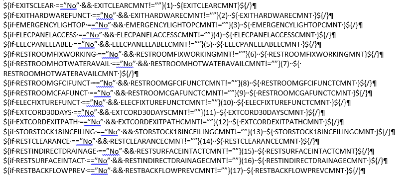

I have a section in my report that displays any comments made to a yes/no/na question in my survey.  There are 17 potential comments that could be made.  The problem that I am facing is that if a comment is not made, there is whitespace in between each question that might have been answered.

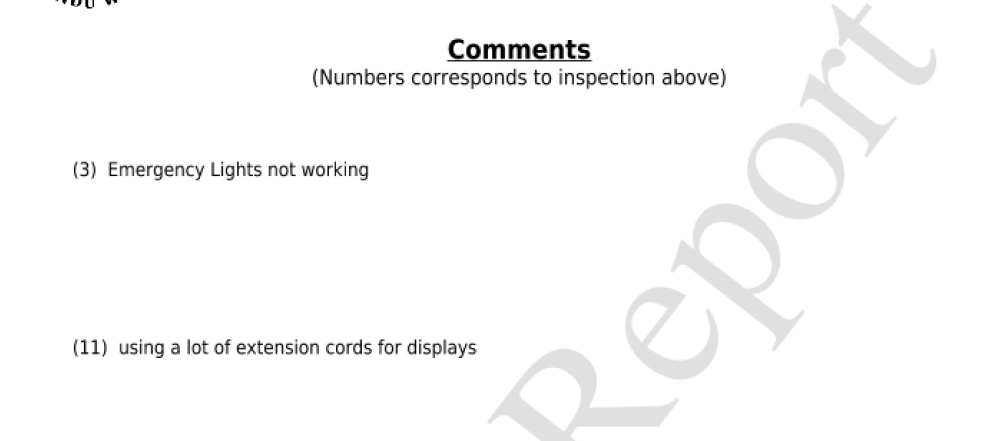

Here is an example:
Formatting looks like this:
Ideally, I would like to remove the whitespace between the questions so they are all stacked nicely.  I haven't been able to figure that out and from what I read it is not possible because there is a carriage return at the end of each conditional statement.

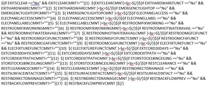

So... What I did was put all the conditional statements on one line with no carriage returns.  What I am wondering is if there is a way to force a carriage return as part of the conditional statement?  I tried adding <br> and that didn't work.  Here is the formatting of my report template:

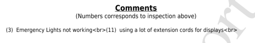

And the result is:
