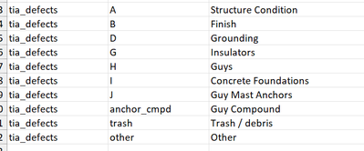

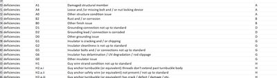

Some visuals from doing this in my surveys:
Choice list that filters:
Choices that get filtered:
Applied on the `survey` sheet:
I'm not sure if this will work with select_multiple questions being the choices that get filtered by a preceding choice, but I suspect it will.
