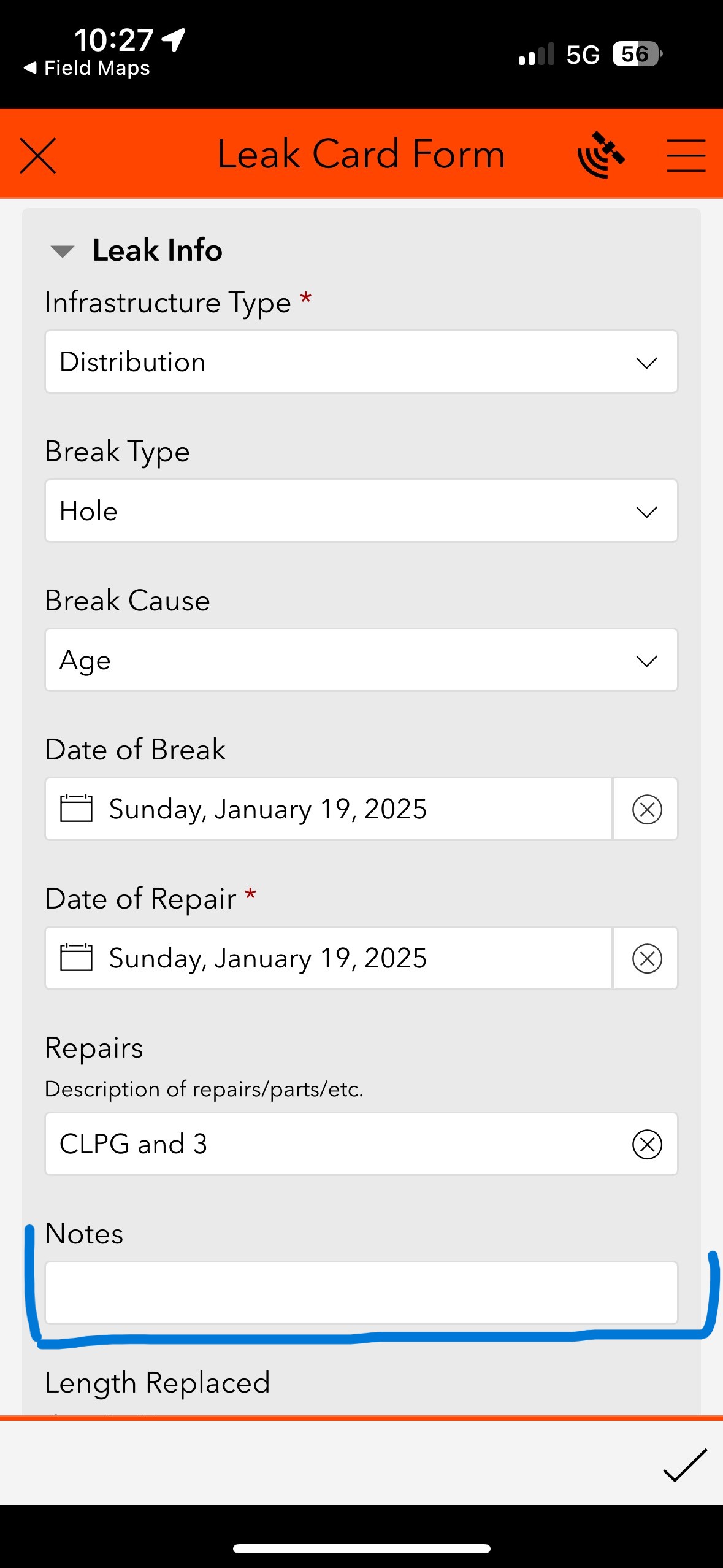

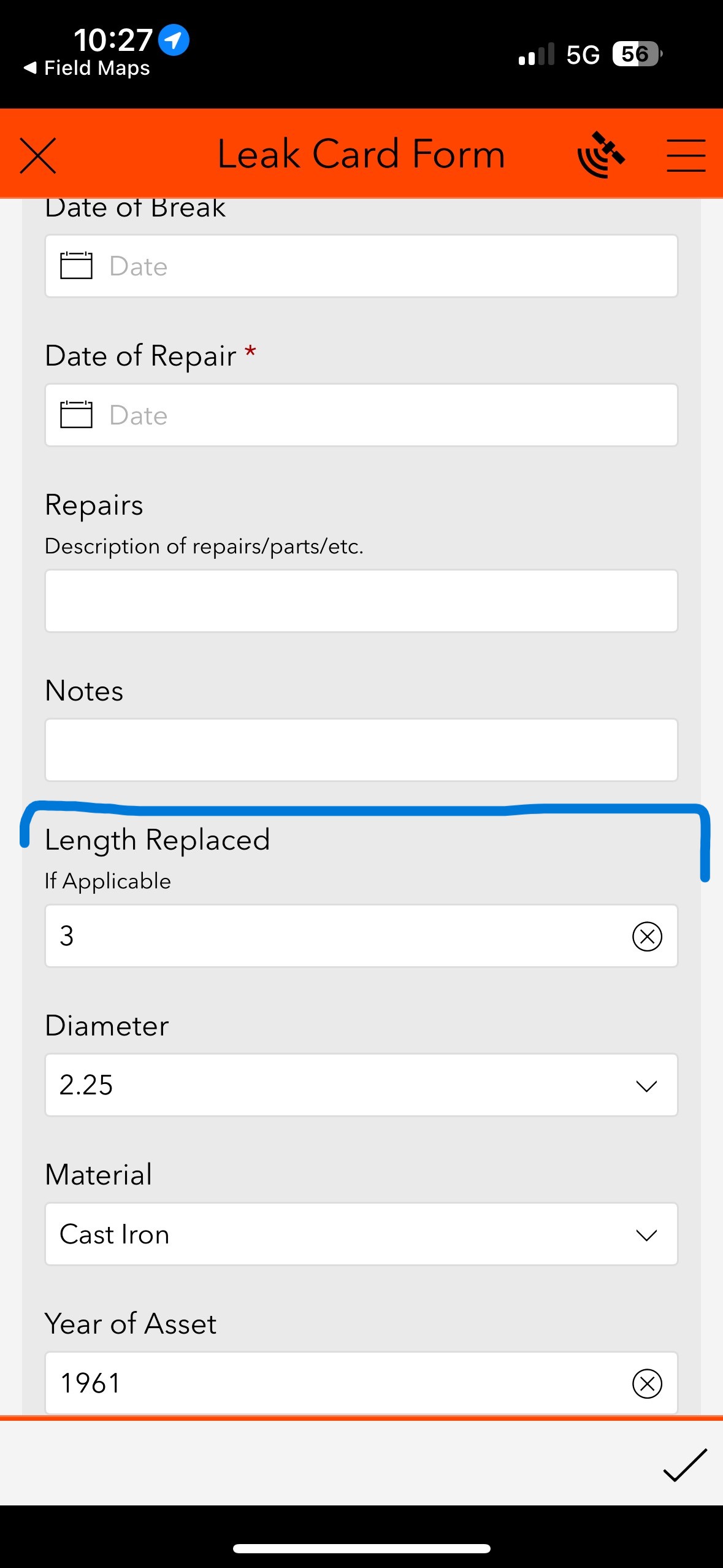

Good morning all,
I have been using passthrough URLs with a lot of success. I am wondering if there is a limit to the URL length or number of fields you can pass through from a Map Viewer pop-up URL (used in Field Maps) to populate a Survey123.
I have matched the fields and types and I am only getting about half of the populated (~10) fields. I have made a second URL with the second half of the fields only and it fills those fields in.

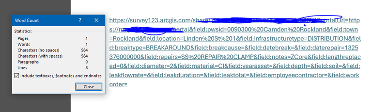

A cursory Google search brings up 1024 and 2048 as common limits to the query chunk of a URL so I have to assume that's what you've hit. Some potential workarounds:

Agreed - probably hitting the character limit! Another option would be to minimize the length of the values being passed. For example, if your domain for INFRASTRUCTURETYPE was:
- "transmission_pole" you could switch to "tp" or 1

Here is an example url that only populates half...looking at 584 characters unless I am misunderstanding?
The url expression is 668.
