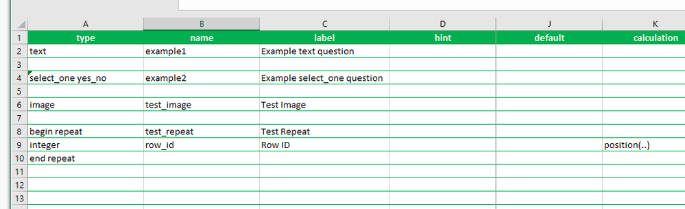

Hi Alison, we've narrowed down the issue to a form including a position(..) calculation in a repeat.
In this basic form example, the image question is outside of the repeat.  The repeat contains 1 question with a position(..) calculation.
Taking a photo is a non-issue, as the photo commits to the question on capture.  Open the photo back up for review, and navigate back out of it, on click to navigate out of the image review state is where we're seeing this.
If the image question had an annotate appearance, the photo does not commit to the question on capture, the user is given the chance to review/annotate, and the issue occurs when committing or navigating out of the image.
So, the problem area (or at least where we're seeing the form crash), is in the image review state, and navigating out of it.
Remove the position(..) calculation from the repeat question, stability is regained.
As you can see, this is about as vanilla of an example as it gets:
