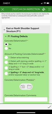

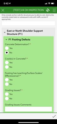

The only thing left to figure out is why photo questions show up as empty grey ovals (issue #1)... that is, only until the user toggles the relevant yes/no question back and forth once or twice.  It definitely is still somehow connected to the characteristics of the appended data since this issue is completely non-existent in completely fresh/blank records.  Examples attached in sequence:
It seems like it's not a "can't attach photos to existing records" error I've encountered previously in Survey123, since photos added after the 'camera/browse for files' buttons correctly appear are properly saved to each question.

Hmm I have seen grey boxes but not for photos.  What is your relevant formula for it?

As for the greyed-out image buttons, the relevance formula is a simple single-argument selected() statement:
selected(${f1_concreteCrack_bool},'yes')
I was wondering if the issue in this case has something to do with the fact that this question is nested within a group that is itself governed by a Relevant formula, but then I remembered this all works fine for records created within Survey123; it's only the existing structure location records that have any of the above-described problems 😕
