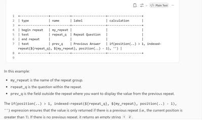

CoPilot suggested this but I ran into issues as the repeat q is a select_one not a text field.

On your code position only works inside the repeat.  Instead you can do count(somerepeatfield) to get the number of repeat records.  Then use that in indexed-repeat.
