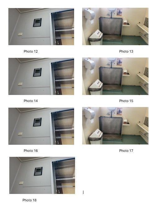

Hello all,

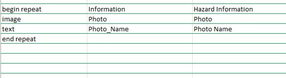

i have a very simple survey123 form to capture photos in a repeat function.
I have photos description with them as well. All i want to do is to export them side by side rather than vertically.
Can someone provide me with working solution.
I tried using this one, but it doesn't work
${#Information}
${Photo | size:200:0 | appearance:"fit"}
${Photo_Name}
${/Information}

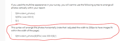

https://community.esri.com/t5/arcgis-survey123-blog/survey123-tricks-of-the-trade-photos/ba-p/897907
I would try this first,
${#Information}${Photo | size:200:0 | appearance:"fit"} ${/}
If that works to get them horizontal, I would then experiment with getting the photo name underneath.
Exporting into columns in S123 is annoying. I do have a process that works fairly well though, but it's a little involved.
Here is the S123 stuff:
typenamelabelcalculationbind::type
begin repeatoddeven_rptoddeven_rpt
calculateoddeven_index position(..)decimal
calculateoddeven_math (round(${oddeven_index} div 2,0)+(${oddeven_index} div 2))-${oddeven_index}decimal
calculateoddeven_output if(${oddeven_math}=0,'B','A')
imageoddeven_imageTake a Picture
end repeat
You would look at ${oddeven_output} for even items (A) and odd items (B). Use this in your feature report.
In the Feature Report,
  1. Add a table with 2 columns and 1 row.
  2. Inside each cell of that table, place a table with 1 column and 2 rows*.
  3. Add the code below to each nested table.
Note, I stole this from a college's unfinished Feature Report. I don't remember where my original example went to. But this gives you the general idea of the layout.
${#pic_rpt}${if oddeven_output==”A”}${pic_img | size:0:0:200:200}
Photo – ${pic_des}${/}
${#pic_rpt}${if oddeven_output==”B”}${pic_img | size:0:0:200:200}
* If my shoddy memory serves, the repeat end marker, ${/}, is supposed to be in the second cell of the nested table so that each photo and associated description get their own cell.
