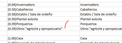

My guess is it is your lists.
You have a new line here - see the height of the cell
The quotes here may cause a problem
You have a lot of / in there but they seem to work.
Hope one of those is it.

I tried removing quotes and spaces and still not working
