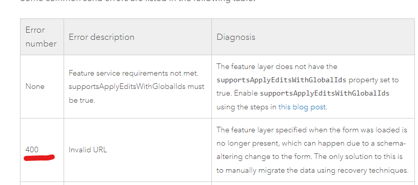

The Survey123 Troubleshoot documentation (Troubleshoot—ArcGIS Survey123 | Documentation) has this reference to a "400" error code, but if there is a Schema problem with the database, why I can submit the survey when not using the Draft or Outbox folders?

Hi @Billy ,
First, I'll note that the diagnosis listed in the documentation generally covers what the Survey123 team has seen as the most likely cause of the symptom being experienced but the error codes can have a number of causes.
Given the message "Account resource file does not exist" in the error, I think this 400 message you are seeing may be a red herring - this likely refers to an attempt to access Survey123 organization settings, which are stored as a resource file attached to your ArcGIS Organization.
