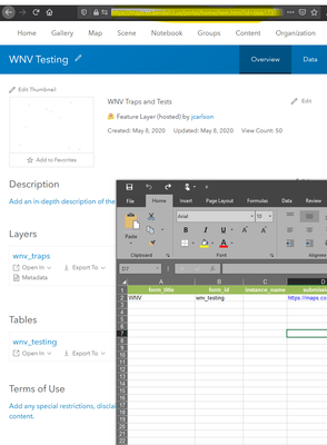

You shouldn't need to specify sublayer. The submission URL goes to the Feature Service, and the form ID specifices which Layer.
For the submission URL, use whatever URL goes to the content item directly. It's probably okay to use the arcgis.com one, but I'd use the full org URL.
What errors are you seeing when you try to use this?
- Josh Carlson
Kendall County GIS

Hi Josh, Thank you for your quick reply. I've updated to the full url. (Thanks for the screenshot.) Removed the sublayer.

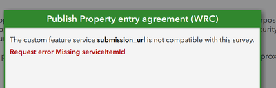

I am getting this error now.

Hi,
The error message indicates your URL is still invalid. What's the current full URL? It should be to the item page (not the feature service URL) and look like this
https://www.arcgis.com/sharing/rest/content/items/21a6c530b31a4523bdff7gg94c9c5d9a
What version of Survey123 Connect?
If you create from the existing service at the time of creating a new survey I don't believe you need to change the submission URL or form ID? I'd only make changes in that scenario if you were looking to target a layer within the item i.e. target the repeat to collect related records.
Cheers,
Chris

I'm getting this message now.
elpinguino
Thanks Chris and Josh for your help. The submission_URL thing makes sense now. The last thing I had to fix to get publishing to work was use one of the back up note fields I had created to use for some of the context info in the form. That was tripping me up. I needed to make the field in the xls match the field in the table.
