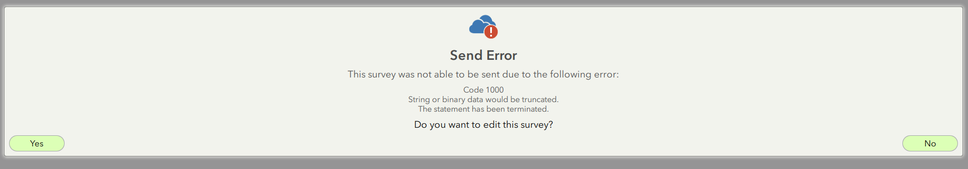

I encountered an error when I wanted to submit a survey form using the Survey123 App. I have been using the form for a while and have not encountered an error previously. I received an Error Code 1000, stating "String or binary data would be truncated. The statement has been terminated.".

This error occurs when a text answer is longer than the field can store.  Aside from typing in a long-is answer (the default storage size for text questions is 255 characters), this can also occur if a survey has been republished with a select one choice whose name is longer than the original choices (this scenario will be fixed for surveys published by the next release of Survey123).

Would you potentially be able to override the column "length" of the question that is storing your answer by adjusting the "bind::esri:fieldLength" to a value that is larger than the longest answer for a select_one question.
Meaning, if you have a select one question that contains an answer that is 400 characters, then you would set the "bind::esri:fieldLength" value to 425, so that selection is not truncated. This has helped me out in the past.
