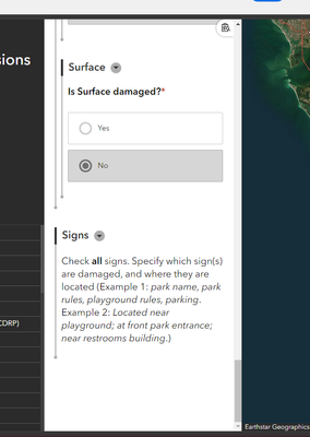

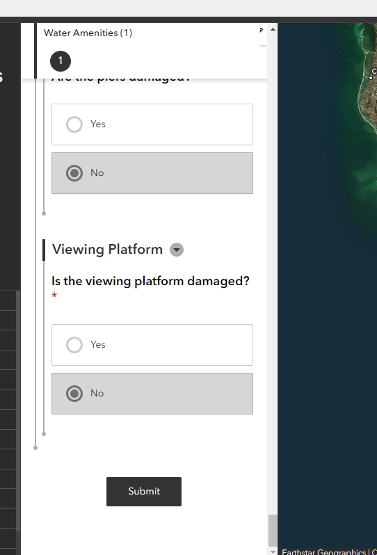

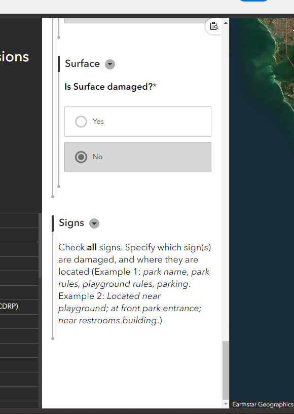

Hello, My team created a Survey123 form for damage assessment and are displaying the submitted survey forms as embedded content in a Dashboard if someone clicks on the survey point.  The problem we are having is the form is so large that when using "?mode=view" to embed it, only a portion of the survey will load but when using "?mode=edit"  the entire survey will load.  We don't want everyone who sees the Dashboard to be able to edit the survey but we do need a subset of people (Non-GIS Users) to have permissions to submit edits.
?mode=view:
Cuts off at the same spot on every survey
?mode=edit:
Loads the entire survey without problem

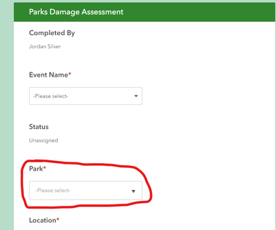

The question is a group that only gets displayed after a park that contains the items is selected above. But this format is used for the entire survey.  For instance, we need to ask questions about damage related to Soccer fields but if the park doesn't have soccer fields those questions don't get displayed.  In the example in my post, the question shouldn't even be shown since its not relevant to that park.
This selection determines what questions get displayed:
