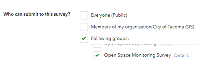

I also shared the S123 items to a group that my end users are a part of. It appears that the group gives the end users access to the items, but I think because it is a collaborative group, Survey123 isn't happy about letting anyone submit a survey (I can't pick the collaborative group from the Survey123 "Who can submit to this survey?" section. I am going to test to see if I create a new, non-collaborative group and add it in Survey123 if this fixes things.

Good news! Once I adjusted the end users to be in a group that Survey123 could see (it won't see a collaborative group, fyi), I was able to send the surveys that were in the outbox successfully. I was extremely worried that adjusting the group sharing was going to cause the survey to need updating on the device and therefore force staff to lose anything in their Survey's outbox.  We didn't refresh the survey, until the following steps were completed:
