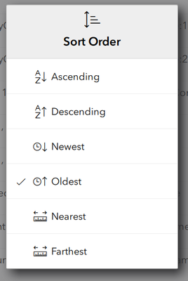

That said, couldn't users just sort the inbox to the oldest entry?
