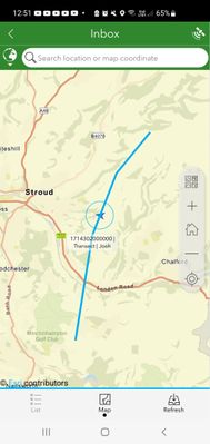

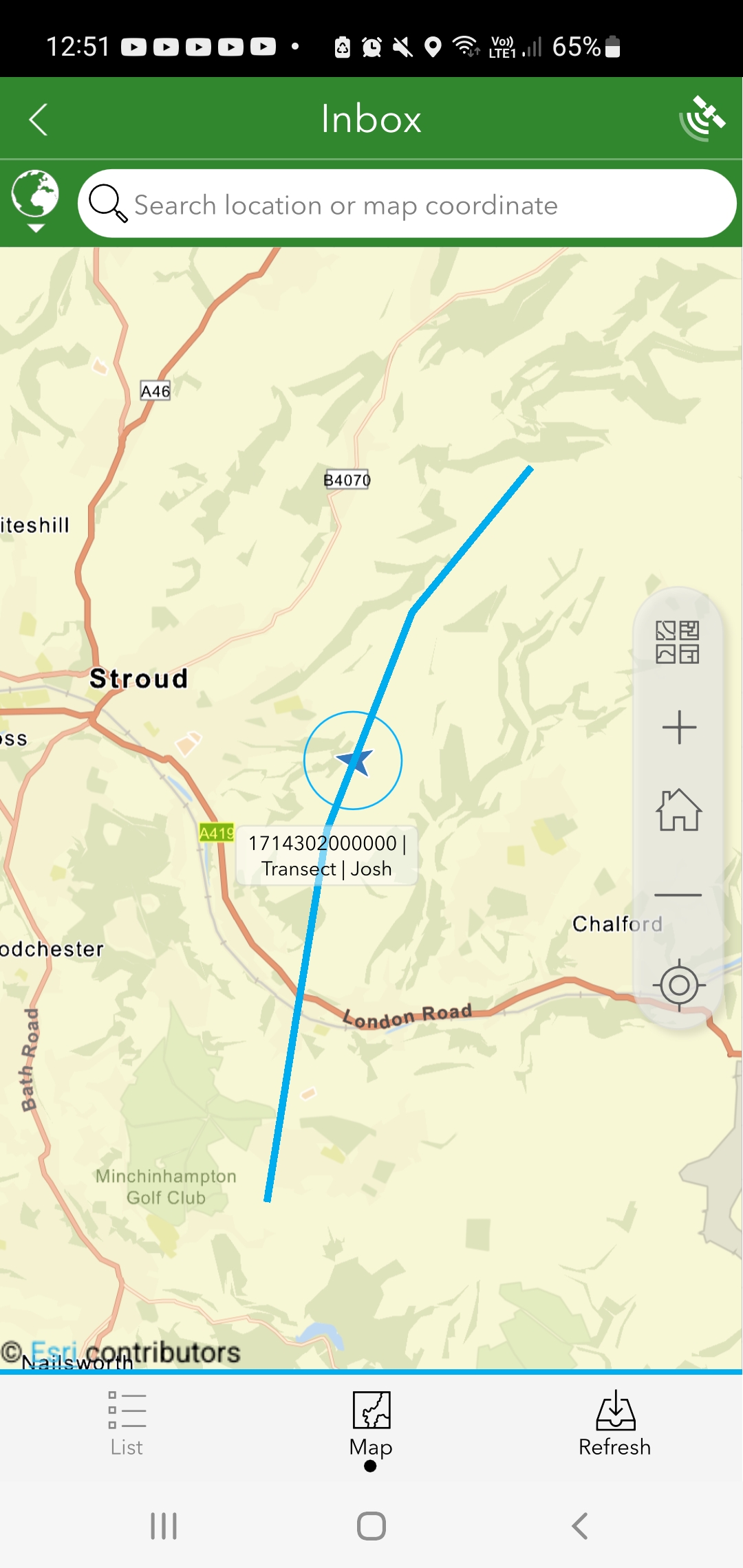

The screenshot shows when the first map question IS entered, but it won't display the repeats on the map?

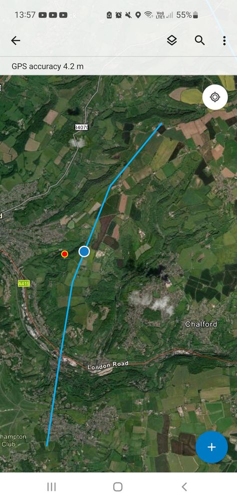

What I would really like is Survey123 Inbox to display both parent features and repeat features as does so already by default in Field maps:
Im trying a work around by using custom URL to open the inbox in Survey from Field Maps but it would be really useful to be able to do it without using field maps
