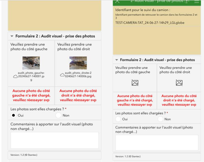

I have encountered the same issue with a survey that had been working fine prior to today. It does look like I can see the take photo/add attachment buttons when I am trying to collect a new survey. It is only when I am working with an existing feature via the Inbox, that I encounter this issue.
I had one device working and another not working and I suspected that it was related to camera access permissions. To test it, I turned off the camera permissions on the device the survey was working on and confirmed that the picture icon with a line through it showed up. When I turned the permissions back on, however, I no longer have the ability to take pictures/add attachments.

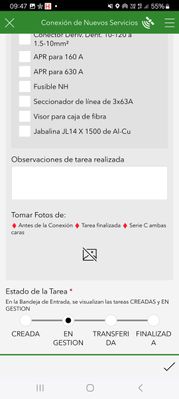

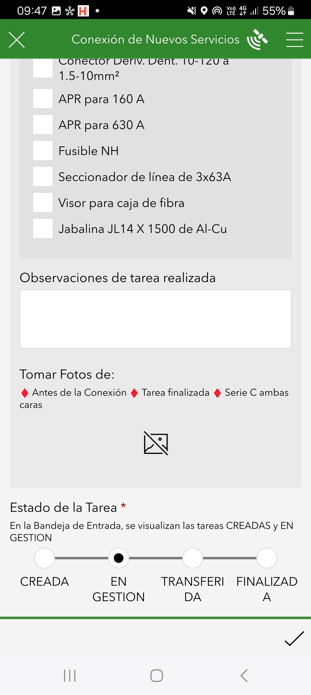

Same here. Since this morning users are not be able to add new photos on submited forms.
Survey123 app was updated automtically yesterday on iPhones and Android phones. Same issue.
On foms some have something on the ESRI parameters (action=edit), other have not.
On the left, view mode. Right one on Edit mode... same form.
Other form/project.
