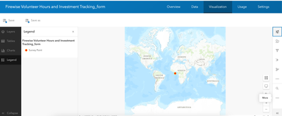

Okay, I am on AGOL and on the visualization tab, where do I delete it?
ToddW_stl
Hi @ScottCratty - "You can delete a field from the Table or Fields view on the Data tab of a hosted feature layer's or table's item page."
and this 3 min video shows how to Delete Survey Records on the ArcGIS Survey123 Website
