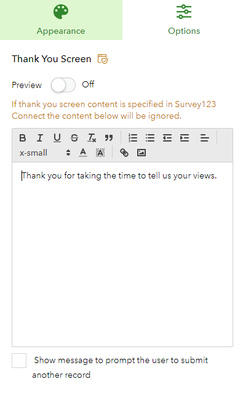

I've been using Survey 123 Connect for a relatively short while, and wanted to customise the thank you screen.
I've used the 'generated_note_prompt_submitted' note (see screen shot below), but the thank you text appears at the foot of the actual survey screen, rather than once the survey has been submitted.
Any suggestions on what I'm doing wrong?

HelenCooper
As noted in the screenshot here -  if thank you screen content is specified in Survey123 Connect the content in the designer will be ignored.  But I still can't find out how to correctly specify the thank you screen in Survey123 Connect.

@HelenCooper I finally got mine to work properly using the web designer method. I had to download and install the newest version of Survey123 (3.12) and then I had to create a brand new survey and import the original survey xml into it!
