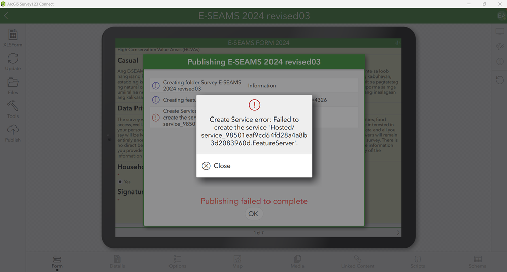

Hello I would like to ask if anyone encountered this problem. I am trying to publish this form but unfortunately this show-up and I don't know how to proceed.

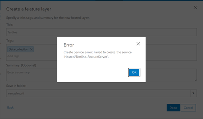

Additionally, can you you create a test hosted feature service in ArcGIS Online/ArcGIS Enterprise you by navigating to Content > New item. Is this successful?

Hello @ekangeles ! Like @wizgis said, try to create a Hosted Service from Content > New Item (Image 1) if you get the same or a similar error, probably the next steps can help you. (at least was the only solution that Work for me)

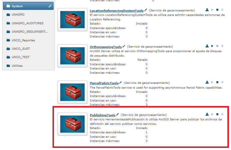

I will supose that you have an Enterprise deployment. (In my case it was 10.9.1) and your Publishing tool Services is started (Image 2)

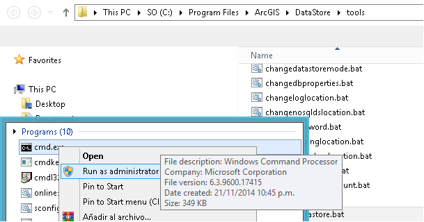

@ekangeles you can also check your DataStore status using this tool, run it in a console with administrator privileges. This tool is in your Arcgis DataStore server
C:\Program Files\ArcGIS\DataStore\tools\describedatastore.bat (image 1)
Be careful with the others tools!
You have to get something like image 2.
Image 1: DataStore tools path
Image 2: Result after run describedatastore.bat
