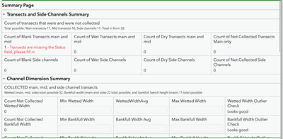

Hello,
The Aggregate functions section of the Repeats documentation has some useful methods to summarize repeat contents. There's also a sample survey called Repeat Aggregation that has a few good examples. You can find the sample survey in the menu that opens when you create a new survey in Connect (see screen cap).
One approach to formatting that data might be to calculate the summary data you need in calculate questions and then to create a note question that references those questions. It may also be useful to use the pages style and include your summary on a second page.
-Barbara

As posted above.  Join, min. max, sum , avg can all be used.  Combine with grid for things like this.
