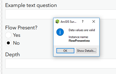

Can you provide more detail?  Based on your description, I have created a basic form that attempts to replicate the condition and it appears the constraint operates successfully.

I am using 3.11 right now.  I just tried the form you posted and it is letting blank go through.

I also developed the form with 3.11.  Given the default I set, I would expect the answer would go through when 'No' is clicked - the condition was if No is clicked, the value must be 0.  Given that you mentioned that you had a default value, I used that as the default.

Ok I am confused then.  Blank is not 0 so why is it not giving an error?  I am trying to say it must be 0.   Is it considering the field not filled out yet maybe?
Also why does string-length not catch it either?  The weird thing is string-length(.) > 0 and string-length(.) != 0 both allow a blank.  But when I try string-length(.) = 0 and put in a value it does fire the error.  string-length(.) > 1 also does make me add at least 2 numbers.  I have tried using string-length(.) for blank a number of times over the years and it never seems to go.  . != '' does not work either.
So it seems that blank is being treated as a special case?
Sorry not sure what I am missing here.  Thanks

If a question has a default value, it is not blank.  As I mentioned, the form sample I provided has a default value that met the requirement when 'No' is selected. A blank value indicates that a question has not been answered and calculations will not fire.  If a question must be answered, you need to set the 'required' value appropriately (either 'yes' or a condition)
